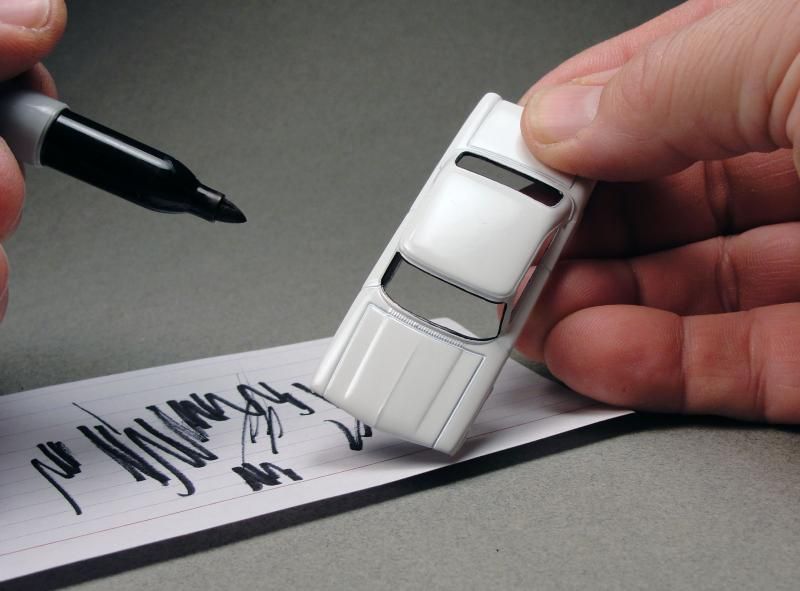

-Determine whether you're working on a light or dark surface. Should you be working on a dark surface like this 2009 Matchbox Mini Cooper, we'll be using the Fine Point Silver Metallic Marker.
-Using the silver marker as a form of primer, apply to areas that require additional colour first, to let the layer dry before applying on top of it.
-After at least three minutes in a cool dry area, you may use an additional colour to apply on top of the silver.
-Silver also works well as a detail for small chrome parts on it's own.
-And as easy as that, simple details are complete.

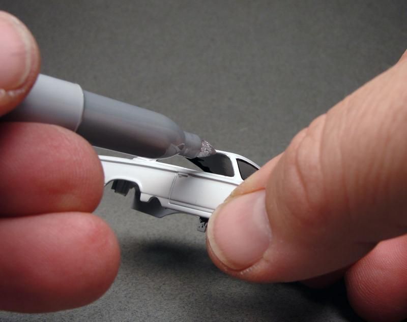

-Applying colours to light surfaces is easier still. Simply apply! Shown below is the 2008 MBX Motorhome.
-Simple details like lights on light surfaces make the overall look pop with authenticity.

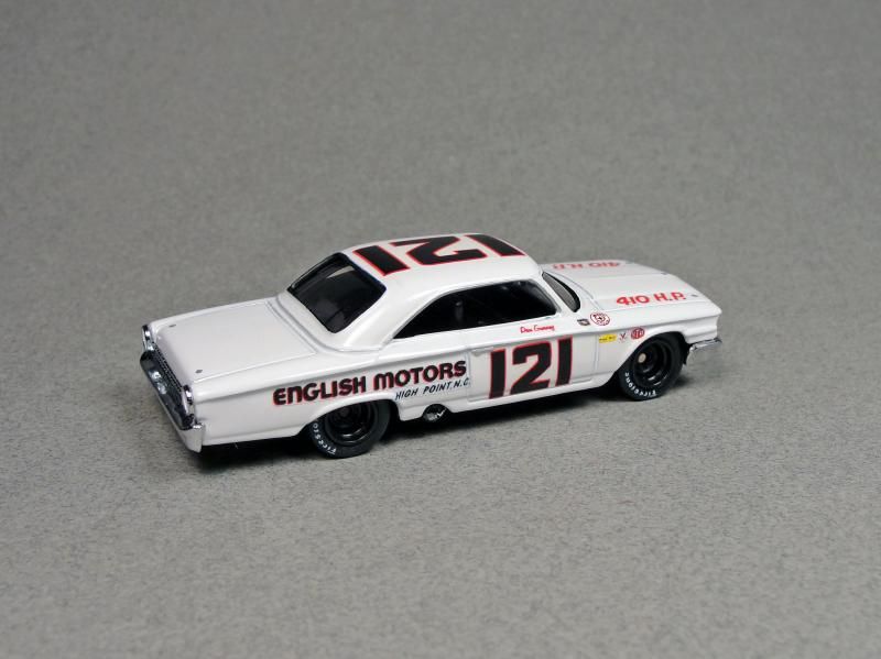

-Another example of an application on a dark surface. <Hot Wheels Flashsider>
-Prime the surfaces with silver.
-After letting the first layer dry, apply a second colour or leave the silver for the chrome and lit details.

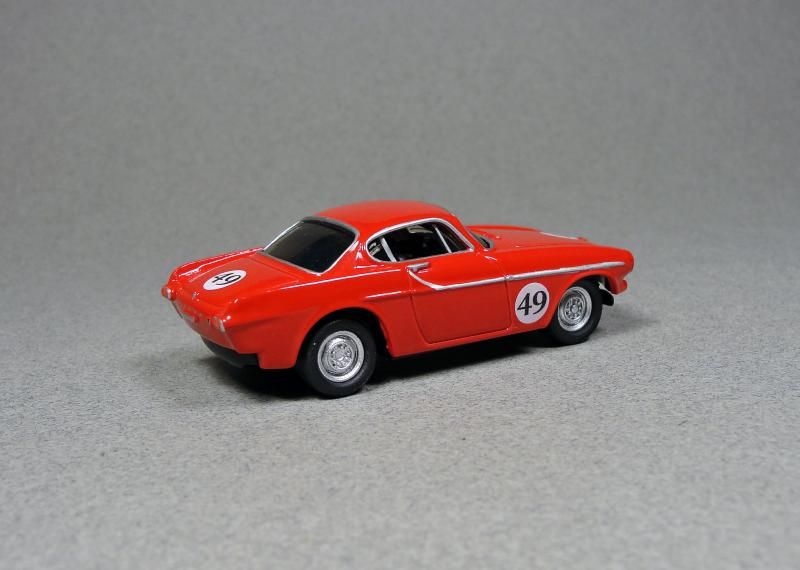

When I do a wheel or pipe like the photo below, I constantly have to chase the rub offs later... and seldom remember to catch them all.
In this pic, I used markers to do the rear wing, the window trim, outer silver of the wheels and the front vent holes. While all those look pretty solid, notice the dings on the pipe, I missed cleaning those back up after handling the car for the decals prior to the photos...
Notice the rear wheel, I speared the ink bu holding it by the tires and did not notice until seeing it in larger photos...
BUT, I still find it the easiest way to do fine details, just make sure you don't touch or touch it back up at a minimum...
All the silver trim is marker...
