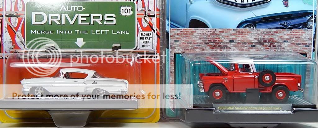

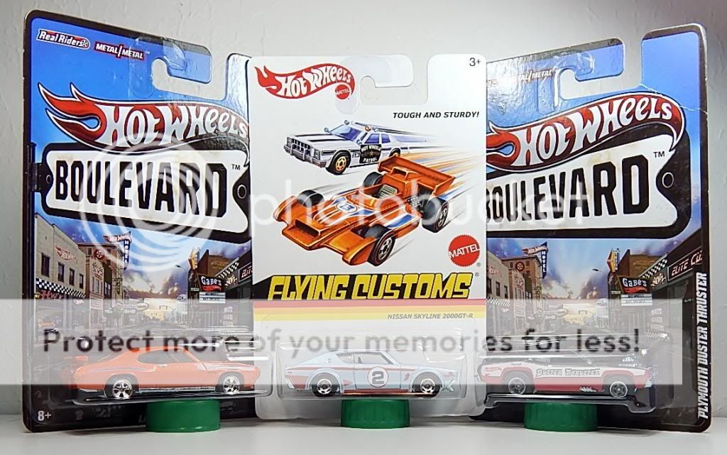

Barracuda68
I'm hungry
I try to take my pics of carded stuff outside on a partly cloudy day, or sunny day if you can find a spot were you can take the pic with out to much glare.
They come like this
Posted ImagePosted Image
I do you use the flash inside as the lighting in here sucks
