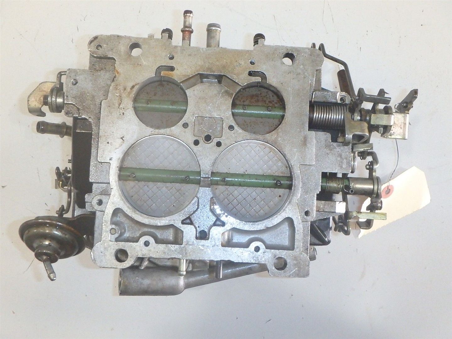

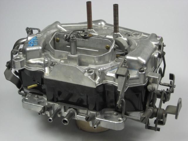

The one with the full black hood was a 1972 340 Plymouth Duster, but I replaced the 1972 engine with a 1971 340 engine. The good ole' government stuck their nose in the muscle cars in 1972 and made all the auto manufacturers cut the compression ratios in the high performance cars. The performance between the 71 and the 72 340 engines was unbelievable. Chrysler also switched the 4bbl carbs from the high performance Thermoquad to the Carter AFB. It gave ya less fuel.
1971 Thermoquad carb:
The secondaries were huge and you knew it when they opened up and began dumping the fuel in...
Also the carbon fiber fuel bowl was suppose to keep the fuel cooler for deliverance to the engine. Colder fuel made more horsepower...

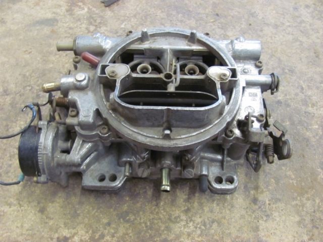

1972 AFB carb:
The secondaries were much smaller in this carb and was suppose to save fuel, so ya didn't get as much fuel when ya stomped it to the floor...LOL

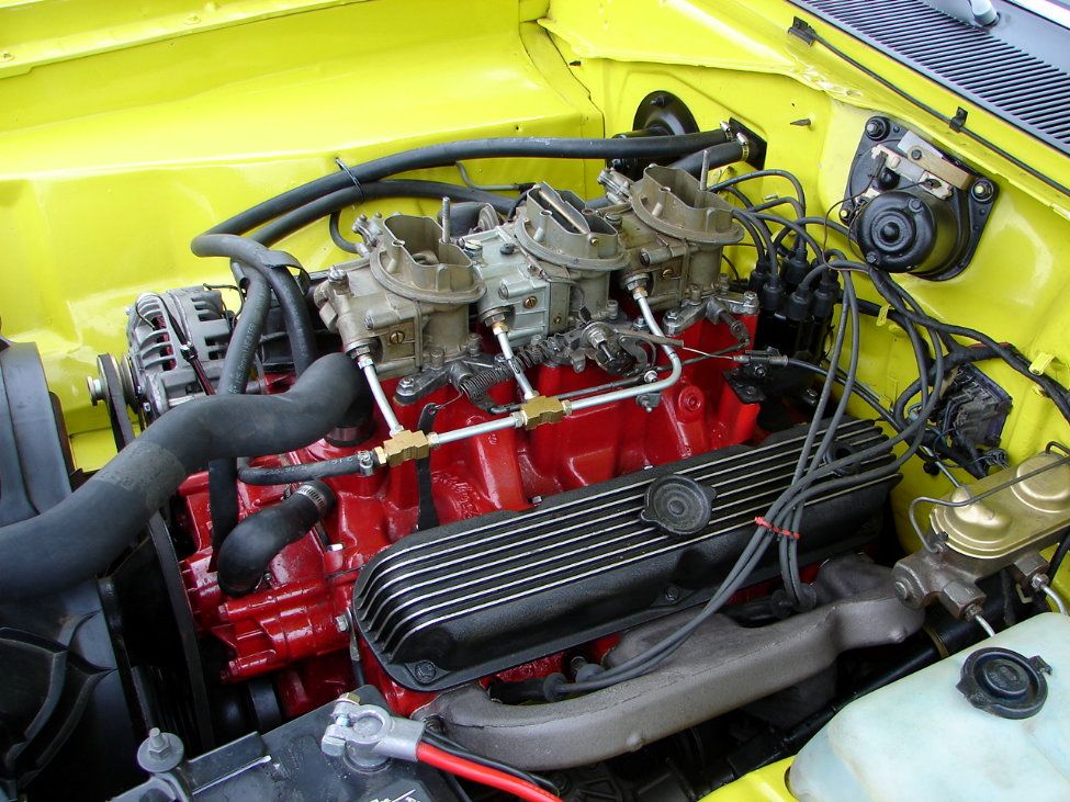

The tri power set up was very impressive looking, but not much for the real performance compared to what ya got from the single 4bbl Thermoquad. Also they were a "REAL PAIN" to keep adjusted equally...
