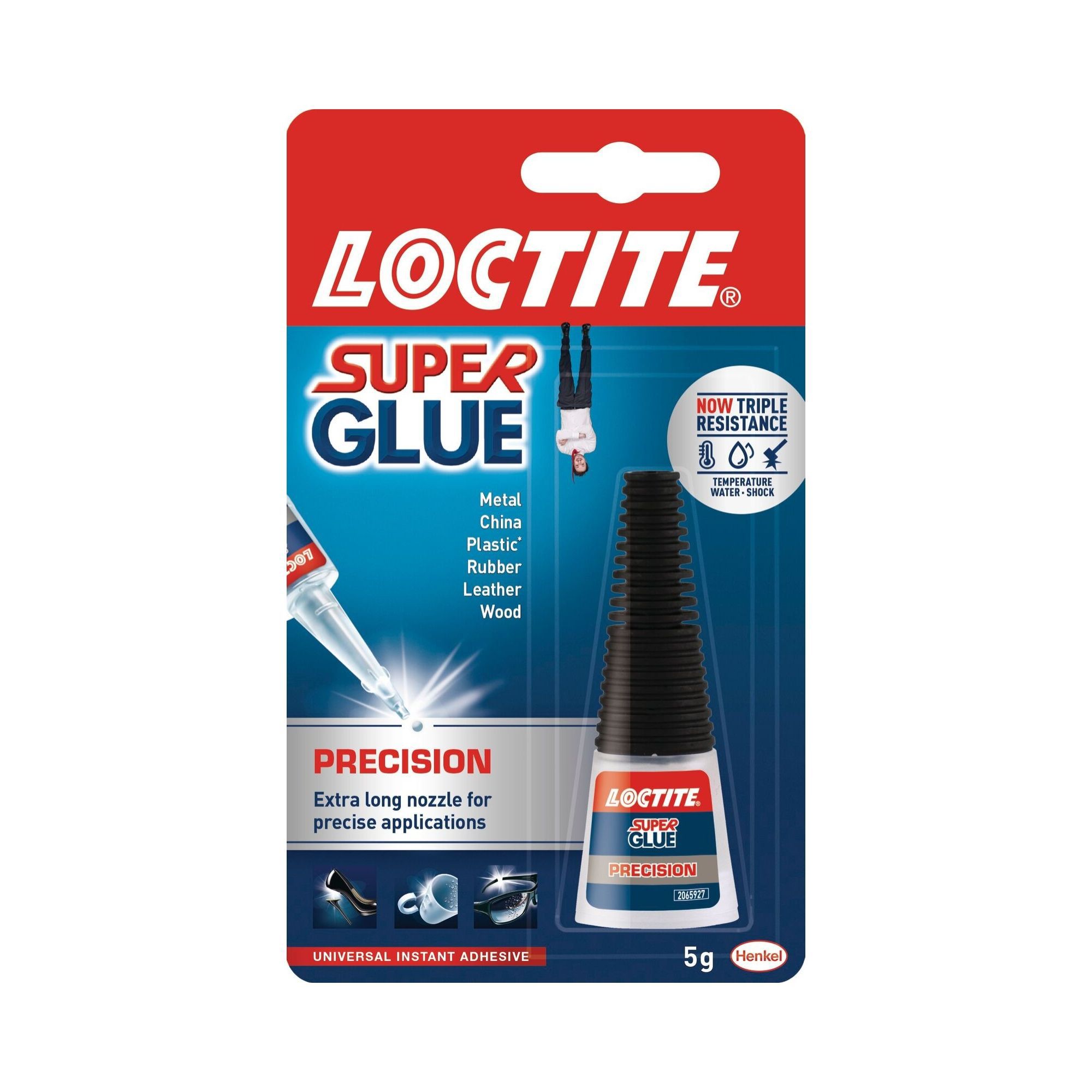

- Super glue. My recommendation: Loctite precision super glue PICTURE

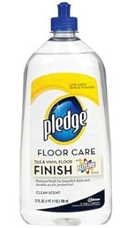

- Pledge Floor Finish "wax", USA VERSION -- EU VERSION (FINNISH LABEL)

If the axle is bent, you can fix it. Snap the axle off and leave a couple millimeters of the axle on both wheels. Use Super glue to glue the axle to the base and be sure to align it as good as you can. Let it dry and you have single axles for both wheels on the same "axle".
Super glue also works on complete axles if the suspension part of the base is broken.

First, use a very fine wet sandpaper (2000) to sand off the scratches. DO NOT get frightened when the glass turns blurry and is not transparent anymore. After you can feel the glass is smooth, wash it properly in water and then apply Quixx Acrylic Scratch Remover with the cloth provided with it. When you polish enough, the glass gets transparent again. BE VERY PATIENT with this as it takes time. After done, dip the glass in a jar full of the floor care product mentioned in Phase I. Use tweezers to hold it while dipping and try to get the glass so it does NOT have any drops. If it does, shake it and dip again. Let the wax dry for some hours at least.

When you are sure the car is good and the paint is dried, assemble it. I just put them together with super glue. It will hold if you just get it right. Use rubber bands (with a piece of cloth between them and the car body) to push the car together and then apply superglue to the rivets. Wait a couple hours, and you are finished!
